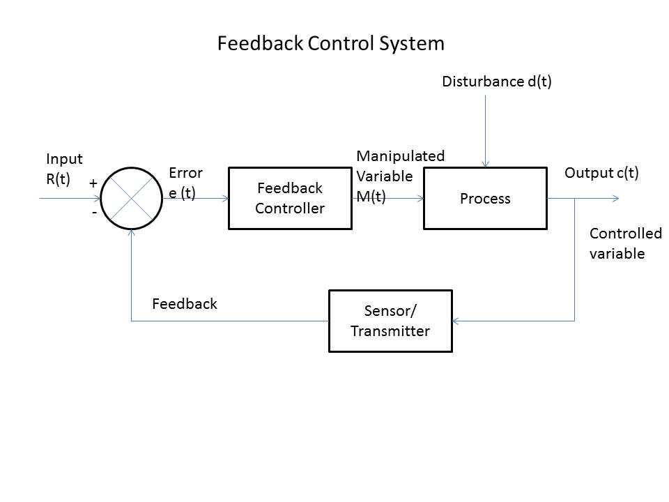

There are number of techniques used for process control system that are useful in the analysis and design of modern process control system. Feedback control system is a type used in this type of control system.
In this feedback control system output is measured and compared with input reference signal. The deviation (error) between the two is used by the controller which will send the output so that error of system becomes zero.
In this example, feedback control system can be explained. In which the output Ca is continuously measured using level sensor and feedback to be compared with input (desired, set (or) reference) level Cd. The error e= (Cd-Ca) is used to adjust the control value by means of an actuator.
