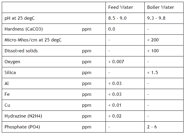

For this boiler, the coordinated phosphate treatment is adopted with using sodium-phosphate (Na3PO4) and hydrazine (N2H4).
Recommended Water Quality
The recommended limitation value of feed water and boiler water is as follows:
