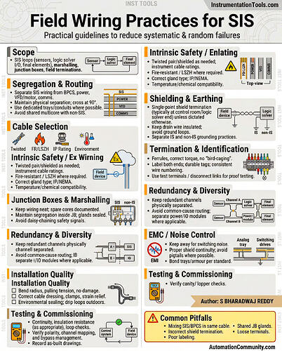

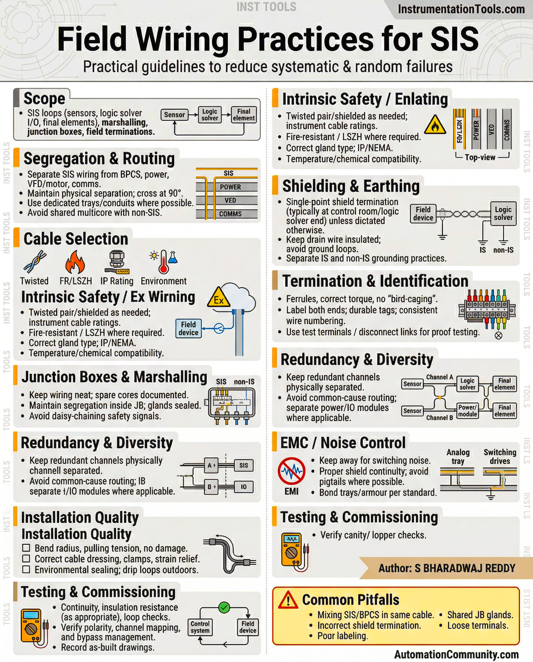

:shield: Field Wiring Practices for SIS β€” Small Mistakes Can Defeat Safety
In a Safety Instrumented System (SIS), even perfect logic cannot protect the plant if the field wiring is wrong :backhand_index_pointing_down:
:gear: Why SIS wiring is critical
:right_arrow: SIS depends on reliable signal transmission
:right_arrow: Wiring faults can cause:
:police_car_light: False trips
:police_car_light: Hidden failures
:police_car_light: Loss of protection
:electric_plug: Best wiring practices for SIS
:green_circle: Use dedicated wiring
:right_arrow: Keep SIS wiring separate from BPCS/control wiring
:warning: Avoid common failure paths
:green_circle: Proper cable shielding & grounding
:right_arrow: Shield analog/safety signals properly
:right_arrow: Ground shield at one side only (as per design)
:high_voltage: Reduces electrical noise & interference
:green_circle: Avoid shared terminals
:right_arrow: Do not mix SIS and non-SIS signals in same terminal loops
:backhand_index_pointing_right: Maintains independence
:green_circle: Use redundant cable routing
:right_arrow: Separate paths for redundant channels (1oo2 / 2oo3)
:high_voltage: Prevents single physical damage affecting all channels
:green_circle: Proper cable identification
:right_arrow: Clear tagging and ferruling
:right_arrow: Separate SIS marshalling panels
:backhand_index_pointing_right: Easier maintenance & troubleshooting
:green_circle: Follow fail-safe philosophy
:right_arrow: Design outputs as:
:small_blue_diamond: De-energize to trip
:small_blue_diamond: Detect open circuit conditions
:factory: Common SIS field devices
:satellite_antenna: Pressure transmitters
:satellite_antenna: Temperature transmitters
:satellite_antenna: Solenoid valves
:satellite_antenna: ESD valves
:satellite_antenna: Flame detectors
:warning: Common mistakes
:cross_mark: Shared power supplies
:cross_mark: Poor grounding
:cross_mark: Mixing SIS & control cables
:cross_mark: No segregation between redundant channels
:bullseye: Key takeaway
:one: SIS wiring must be independent
:two: Noise & common failures must be minimized
:three: Good wiring = Reliable safety protection
:backhand_index_pointing_right: In SIS, wiring is not just installation… it’s part of the safety design.
