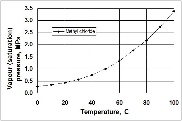

Vapour/pressure systems (see Fig. 2) are filled by 2/3 of the volume of the thermal bulb 1 by liquid 2 which has a low boiling temperature, for example, freon (refrigerant), propylene, acetone, ethylbenzene, methyl chloride, etc. Another (upper) part of the thermal bulb and the capillary tube 3 is occupied by saturated vapour 4 of this liquid. Vapour pressure depends only on the temperature of saturated liquid in the thermal bulb, and therefore, does not depend on the variation of the ambient temperature (this is an advantage). Relationship between saturation pressure and temperature for liquids is non-linear (see Fig. 3). Hence, the scales of these thermometers are non-uniform, with more widely spaced increments at high temperatures. The length of the capillary tube usually does not exceed 25 m.

• non-uniformity of the temperature scale.
Figure 3:. Saturation (vapour pressure) curve for methyl chloride.
