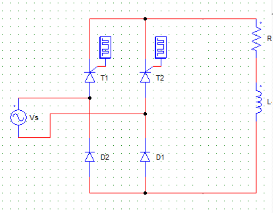

Find the circuit turn-off time (Tc) for the below given semi-converter configuration.
Take α = 30° and Vs = 230√2 sin100t
A. 20π radians
B. 5π/6 radians
C. π/120 radians
D. 3/π radians
Answer: C
