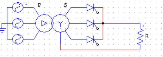

Find the expression for average output voltage at R for the below given configuration.
Take firing angle as α = 15°, transformer ratio as 1:1:1 and Vmp as the maximum value of phase voltage at the supply.
A. (3Vmp/2π) x cosα
B. (3√3Vmp/2π) x cosα
C. (3√3Vmp/2π) x sinα
D. (3Vmp/2π) x sinα
Answer: B
