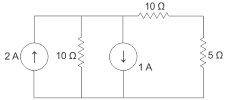

Find the total power absorbed by the resistor in the given circuit.
A. 6 W.
B. 12 W.
C. 24 W.
D. 30 W.
Answer: A
