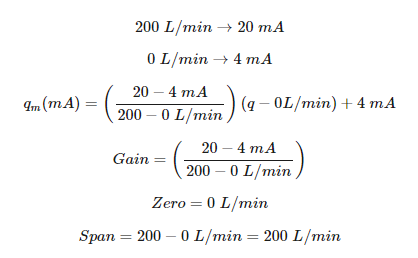

A flow meter can detect flows up to 200 L/min. A flow of 200 L/min produces a sensor output of 20 mA while a flow of 0 L/min produces a sensor output of 4 mA.
Develop an expression for the flow meter and give the transmitter gain, zero, and span.
