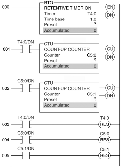

For the 24-hour clock program, a false-to-true transition of ___
For the 24-hour clock program, a false-to-true transition of rung 002 increments the clock by:
A. 1 ms.
B. 1 s.
C. 1 min.
D. 1 h.
Answer: D
