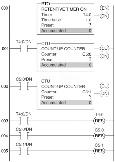

For the 24-hour clock program, assume the accumulated count of ___
For the 24-hour clock program, assume the accumulated count of Counter C5:1 is 14 and that of C5:0 is 10.
The correct time of day would be:
A. 2:10 p.m.
B. 10:14 a.m.
C. 10:14 p.m.
D. 2:10 a.m.
Answer: A
