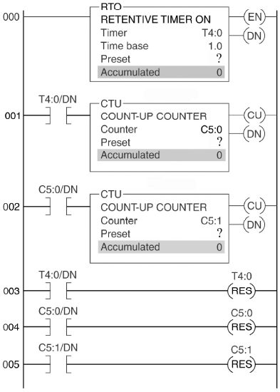

For the 24-hour clock program, Rung 003 undergoes a ___
For the 24-hour clock program, Rung 003 undergoes a true-to-false transition once every:
A. 60 s.
B. 2 min.
C. hour.
D. 24 h.
Answer: A
