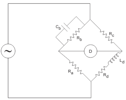

For the AC bridge circuit shown in figure at balance the value of Rd
will be
A. (Ra/Rc).Rb.
B. (Rc/Ra).Rb.
C. (Rc/Rb).Ra.
D. (Rb/Rc).Ra.
Answer: C
will be
A. (Ra/Rc).Rb.
B. (Rc/Ra).Rb.
C. (Rc/Rb).Ra.
D. (Rb/Rc).Ra.
Answer: C
