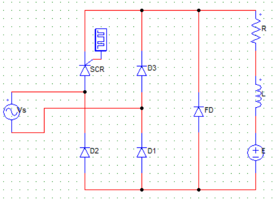

For the below given circuit configuration, the SCR is fired at angle α.
For continuous current mode, find the expression for the average output voltage
A. (Vm/2π) (1+ cosα)
B. (Vm/2π) (2+ cosα)
C. (Vm/2π) (3+ cosα)
D. (3Vm/π)
Answer: C
