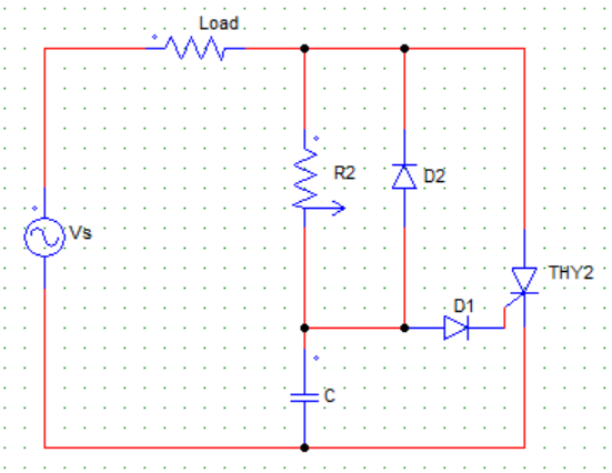

For the following RC triggering circuit with R load and a firing ___
For the following RC triggering circuit with R load and a firing angle of α, the voltage across the SCR (thy2) will be zero for
Voltage Across SCR
A. ωt = 0 to α & ωt = π to 2π+α
B. ωt = 0 to π
C. ωt = α to 2π
D. ωt = α to π
Answer: D
