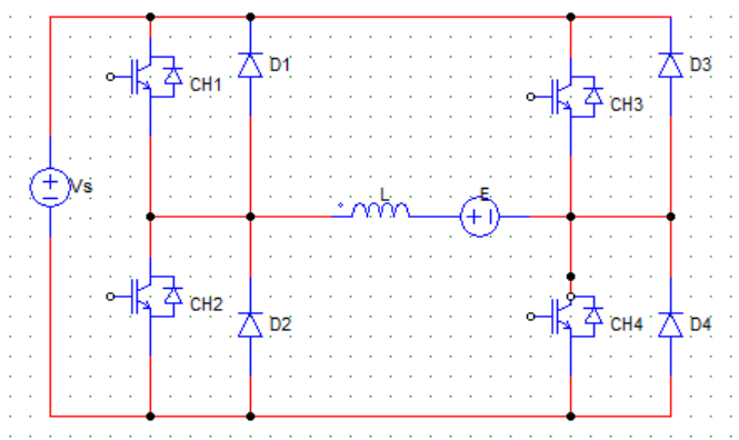

For the fourth quadrant operation, the current flows through
A. CH1, D2, L and D1
B. CH4, D3, L and D4
C. CH4, D2, L and E
D. CH1, D2, L and D3
Answer: C
C. CH4, D2, L and E
Answer: C
