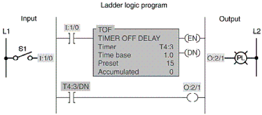

For the programmed timer circuit shown, the pilot light should come on:
Ladder Logic Program
A. as soon as the switch is closed.
B. before the switch is closed.
C. for 15 seconds after the switch is opened.
D. both A and C.
Answer: D
