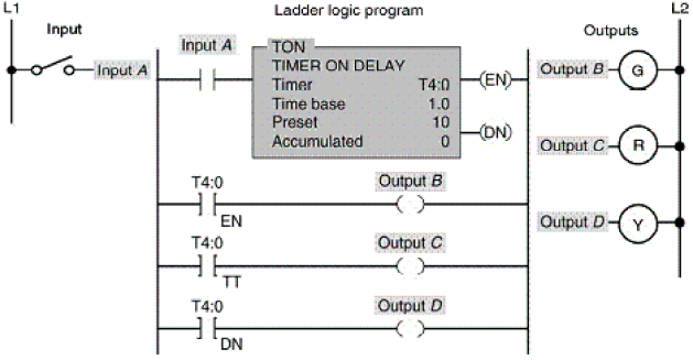

For the programmed timer circuit shown the ____ bit of the timer functions similar to an instantaneous contact.
A. DN
B. EN
C. PB1
D. PB2
Answer: B
