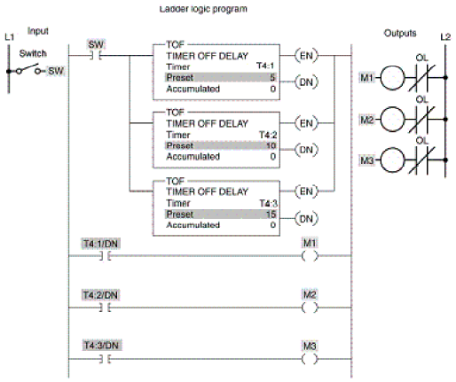

For the programmed timer circuit shown, when the switch is initially closed motor(s) _____ start(s) immediately.
A. M1
B. M2
C. M3
D. all of these
Answer: D
