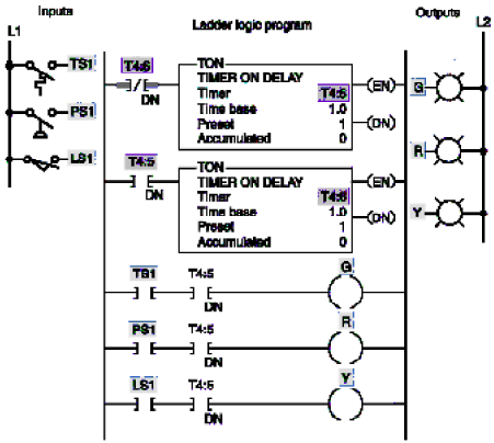

For the programmed timers shown, the output of ___
For the programmed timers shown, the output of timer T4:5 :
74 Programmed Timer
A. turns on after a 10-s time delay and remains on.
B. turns off after a 2-s time delay and remains off.
C. turns on after a 3-s time delay and remains on.
D. is pulsed on and off at 1-s intervals.
Answer: D
