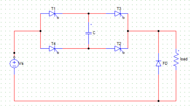

For the step down chopper shown in the figure below, Vs = 100 V and the duty cycle of the switch is 0.8.
The load is sufficiently inductive so that the load current is ripple free.
The average current through the diode (D) under steady state is
A. 2 A
B. 1.6 A
C. 8 A
D. 6.4 A
Answer: B
