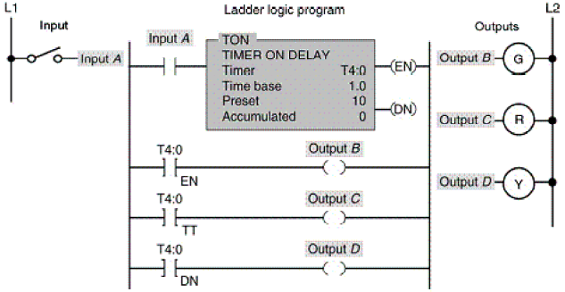

For the timer program shown, output D is switched ON when:
A. power is applied.
B. input A is closed.
C. the timer is accumulating time.
D. the accumulated value equals the preset value.
Answer: D
