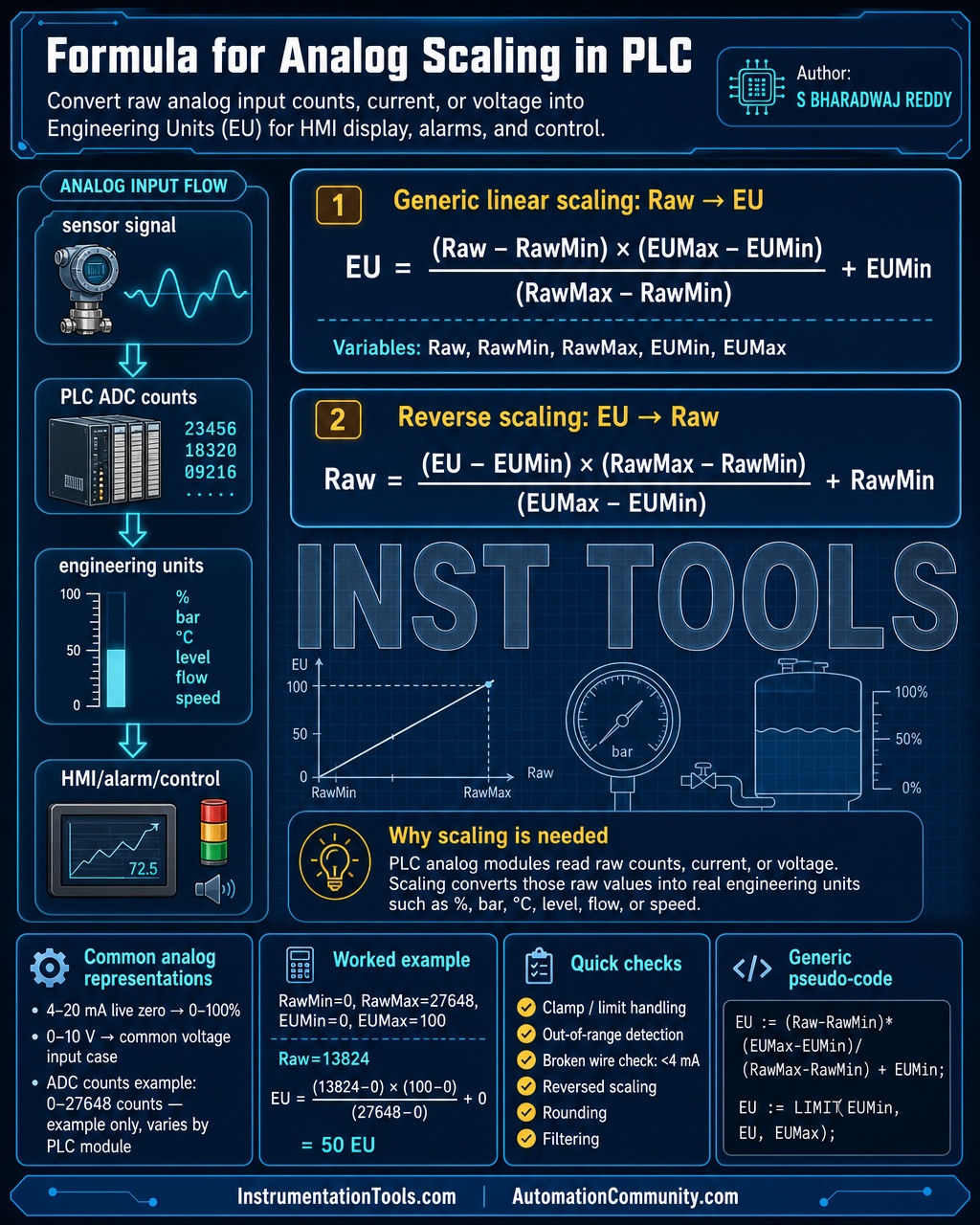

:triangular_ruler::gear: ANALOG SCALING FORMULA IN PLC: Convert Raw Input Into Engineering Units! :counterclockwise_arrows_button:
A PLC analog input usually does not directly give you the actual process value.
For example, a pressure transmitter may measure:
0–10 bar
while the PLC analog input module may provide a raw digital value such as:
0–27648
So we need to scale the raw PLC value into engineering units.
:small_blue_diamond: The Standard Analog Scaling Formula
Where:
:small_blue_diamond: EU = Engineering Unit value
:small_blue_diamond: Raw = Actual PLC raw input
:small_blue_diamond: Rawmin = Minimum raw input
:small_blue_diamond: Rawmax = Maximum raw input
:small_blue_diamond: EUmin = Minimum engineering value
:small_blue_diamond: EUmax = Maximum engineering value
:factory: Example: 4–20 mA Pressure Transmitter
Suppose:
:satellite_antenna: Transmitter range = 0–10 bar
PLC raw range:
4 mA = 0
20 mA = 27648
If the PLC receives:
Raw = 13824
Then:
:bullseye: PLC displays = 5 bar
:counterclockwise_arrows_button: Another Example
Suppose a temperature transmitter has:
:thermometer: Range = βˆ’50 to 150Β°C
PLC raw range:
0–27648
Raw input:
13824
Then:
:white_check_mark: Raw 13824 = 50Β°C
:bar_chart: 4–20 mA Scaling Formula
For a 4–20 mA signal, a commonly used direct formula is:
Example:
:satellite_antenna: Transmitter = 0–100 bar
:inbox_tray: Input = 12 mA
:bullseye: 12 mA = 50 bar
:warning: Don’t Forget the Difference
Raw Scaling:
:backhand_index_pointing_right: PLC raw value β†’ Engineering Units
Current Scaling:
:backhand_index_pointing_right: 4–20 mA β†’ Engineering Units
Both ultimately perform the same job:
:counterclockwise_arrows_button: Convert the input signal into a meaningful process value.
:light_bulb: Easy Formula to Remember
Engineering Value = Low Limit + [(Input βˆ’ Input Low) Γ— Range] Γ· Input Range
This formula is widely applicable to:
:gear: PLC
:desktop_computer: DCS
:bar_chart: SCADA
:control_knobs: Analog Input Modules
:electric_plug: 4–20 mA Systems
