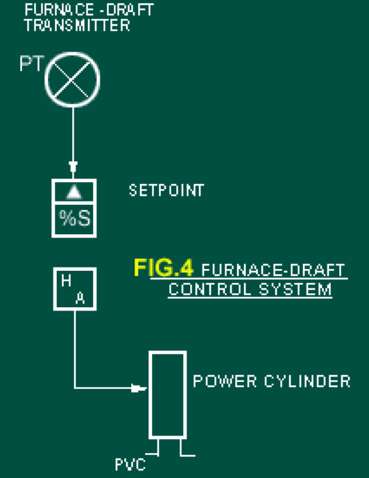

In all the combustion control system, irrespective of the type, an independent control loop is provided to maintain a constant negative draft inside the combustion chamber.
Any variation from the set value is detected by the controller, and the resultant output signal directly goes to regulate the position of the I.D fan damper.
