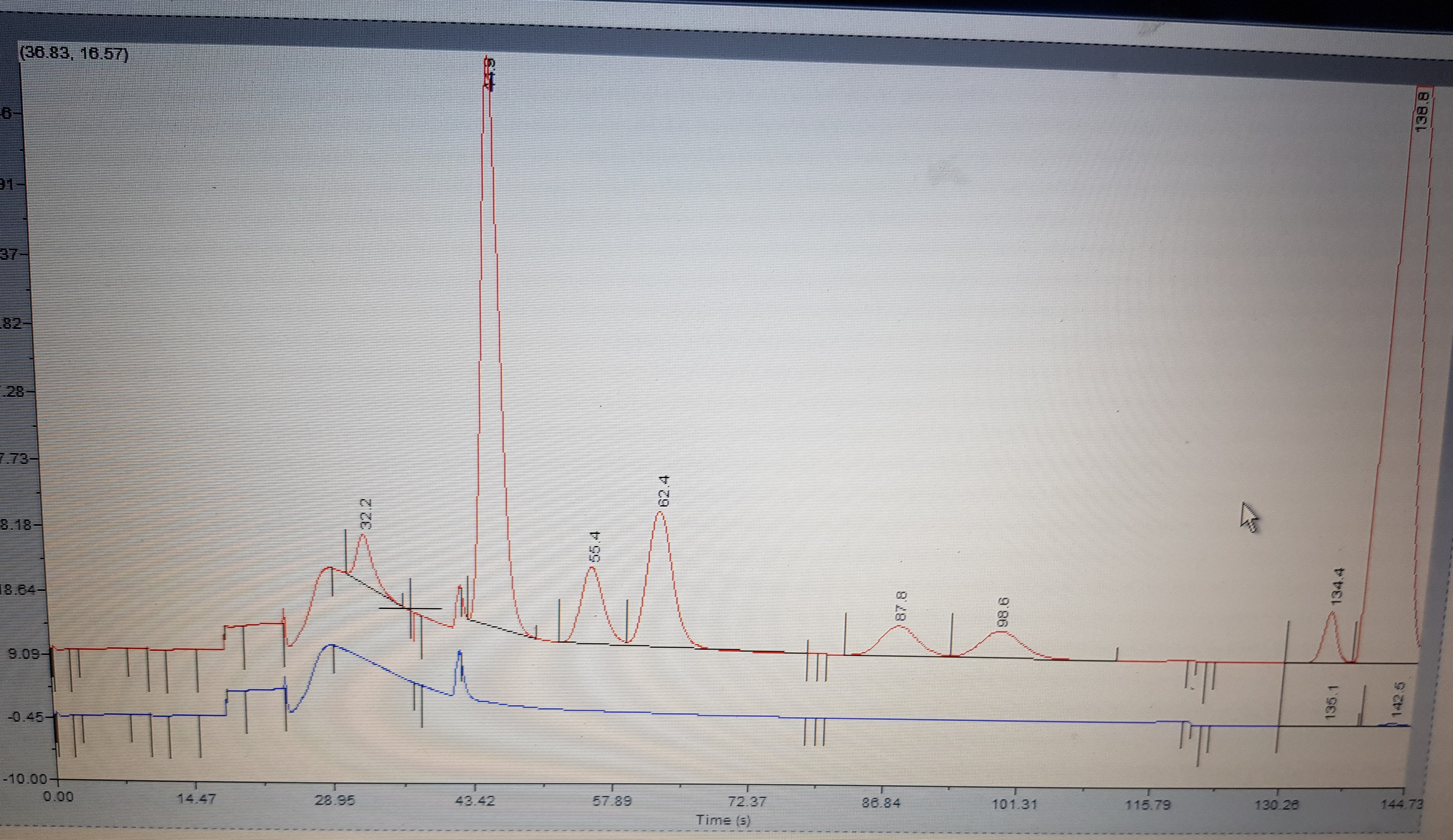

Gas Chromatograph (GC) Tuning
Please I need your help for adjust/tuning GC DANIEL 370XA with MON2020 software using chromatogram (attached), in the chromatogram you can see irregular curves (baseline no horizontal) from 0 to 72.37 seg, I was trying to adjust changing open/close valve times (TIMED EVENTS) but C6+ analysis decrease from 0.056 to 0.00%, the actual total time for analysis is 240 seg, changing open/close valve times the total time can be increased from 240 to 280 seg can be this problem?
somebody have someone procedure for tuning/adjust GC DANIEL 370XA?

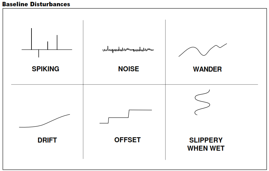

Baseline problems
Baseline problems could be divided into 5 categories: drift, noise, offset, spiking and wander.
  • Drift means slow baseline movement in one direction
  • Noise is rapid and random movement of the baseline position
  • Offset is sudden unexplained change of the baseline position
  • Spiking is presented by peaks with no width, either positive or negative
  • Wander is low frequency noise
Downward drift

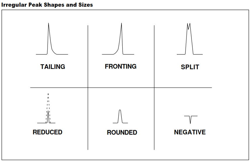

Distorted peak shapes
All peaks redused in size
Possible cause Suggestions
Sample validity Check the concentration and stability of the sample.
Flattened top peaks
Detector overload. The broad peaks may have a rounded top or even valleys in the top. Reduce sample volume, dilute with solvent or use higher split ratio.
Overload of the signal processing electronics. The peaks are clipped with flat tops. Attenuate detector output or reduce sample amount (see above).
Fronting peaks
Fronting peaks are usually the result of column overloading. In this case, the effect should be a function of injection volume. Solutions include reducing the injection volume or using a column with greatr capacity. Columns with larger diameter or thicker stationary phase coatings generally have larger sample capacities, however, resolution may be reduced.

Too much thanks, but I forget a detail, when I change the gas sample for Helium pure (another bottle of same carrier gas) the chromatogram from 0.0 to 43.42 seg. no change (Red line is for Natural Gas Standart and Blue line is for Helium pure), so am thinking the problem is contamination because with Helium pure the chromatogram should be horizontal line without peaks. how to can solve this problem?, I already did a 12-hour running analisys wit helium pure but the chromatogram no change.

@fxx
We too face the basline issue once when we change the Helium cylinder supplier.
The quality of helium gas is degrated and started the baseline problem in GC.
Make sure to check the helium gas cylinder.
Aslo is this issue started after changing the helium gas cylinder? then replace this cylinder with new one and check again. if you have sufficient helium in old cylinder (for few hours only) then us the same for confirmation of this issue.
Sometimes you need to clean the six port valve also.
Please confirm from O.E.M. to avoid unnecessary trail and error tests. Because there is a high chance of GC analysis distrubance with these trails.
