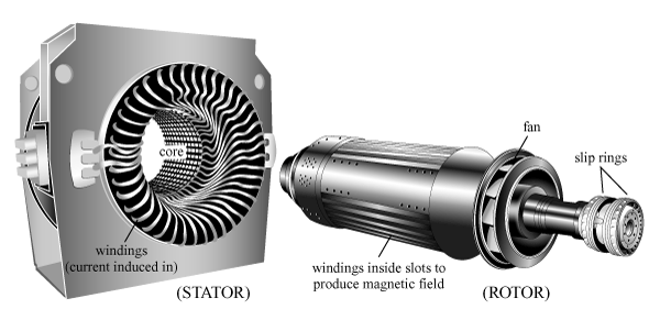

Alternator:
Without a commutator, a dynamo becomes an alternator, which is a synchronous singly fed generator. When used to feed an electric power grid, an alternator must always operate at a constant speed that is precisely synchronized to the electrical frequency of the power grid. A DC generator can operate at any speed within mechanical limits, but always outputs direct current.
Typical alternators use a rotating field winding excited with direct current, and a stationary (stator) winding that produces alternating current. Since the rotor field only requires a tiny fraction of the power generated by the machine, the brushes for the field contact can be relatively small. In the case of a brushless exciter, no brushes are used at all and the rotor shaft carries rectifiers to excite the main field winding.
The two main parts of a generator or motor can be described in either mechanical or electrical terms.
Mechanical:
Rotor : The rotating part of an electrical machine
Stator: The stationary part of an electrical machine
Electrical :
Armature: The power-producing component of an electrical machine. In a generator, alternator, or dynamo the armature windings generate the electric current. The armature can be on either the rotor or the stator.
Field: The magnetic field component of an electrical machine. The magnetic field of the dynamo or alternator can be provided by either electromagnets or permanent magnets mounted on either the rotor or the stator.
Because power transferred into the field circuit is much less than in the armature circuit, AC generators nearly always have the field winding on the rotor and the stator as the armature winding.
Only a small amount of field current must be transferred to the moving rotor, using slip rings.Direct current machines (dynamos) require a commutator on the rotating shaft to convert the alternating current produced by the armature to direct current,so the armature winding is on the rotor of the machine.
