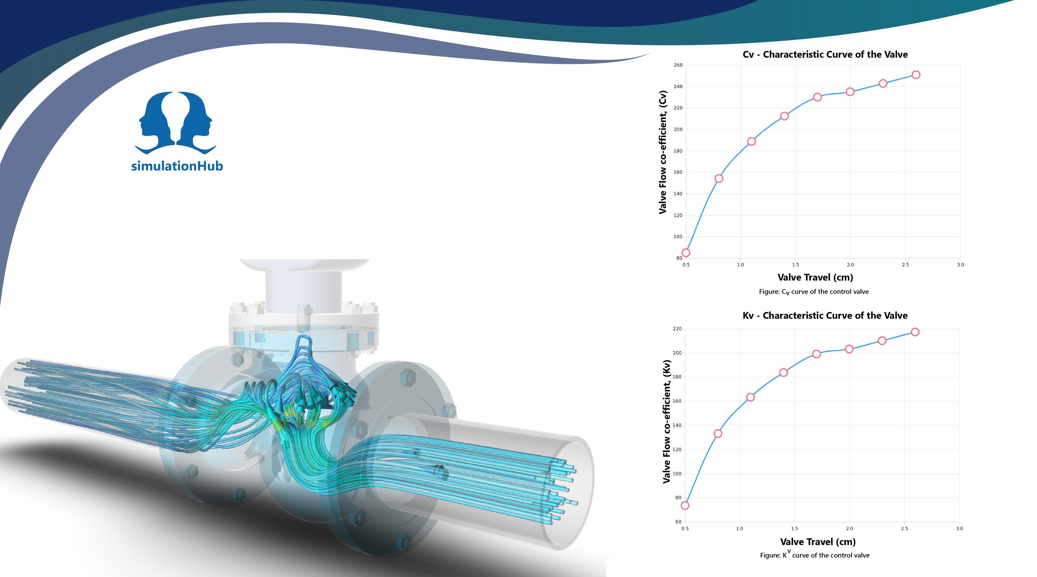

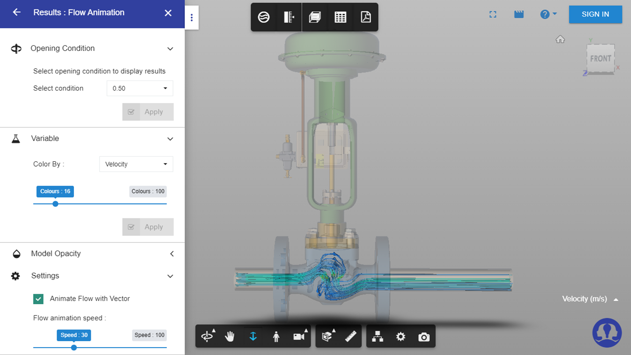

- FLowlines
Flow lines represent the path followed by fluid particles from an inlet to the outlet of a valve. The animated arrows on the flowlines indicate the direction of velocity vectors at that point and speed is based on the magnitude of velocity. This is similar to the flow visualization technique where some colored particles are injected from an inlet and its trace in the flow domain is marked. Along with that path, the flow lines also display the magnitude of velocity and pressure of each particle along its path. This is useful information to identify flow separation and recirculation zones in a valve.

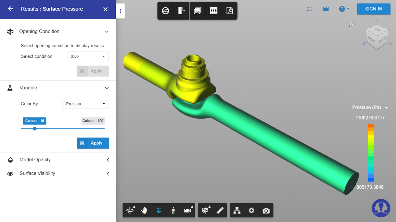

- Surface pressure
Surface pressure is pressure contours plotted on the surfaces in contact with the fluid. This information is useful to identify the regions of low-pressure zones and the possible locations of flow recirculation.

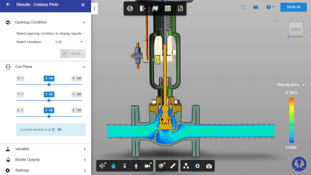

- Contour plots
The contour plot is a pictorial representation of flow property variation in the fluid domain. The location of flow separation, high velocity, and low-pressure regions are a few examples of insights that can be gained through CFD results visualization. Contour plots display the velocity or pressure variation about any 2D cut section of the geometry.

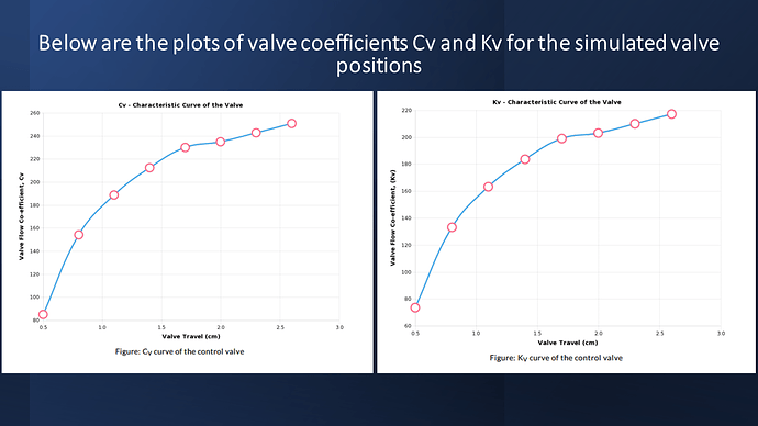

- Performance data and valve characteristic curves
Autonomous Valve CFD app generates various valve performance data including valve coefficients like Cv, Kv and Cdt at various opening conditions. Flow performance coefficients (Cv, Kv) are determined based on the procedures prescribed by the IEC & ANSI standards. The Cv value is calculated as a function of both the line flow rate and the pressure drop across the valve. The app provides valve flow performance coefficients in both Gross as well as Net values.
One of the basic requirements in valve technology is the flow loop testing of the valves. The valve flow coefficient is important for the end-user to select the valves for process applications. In this process of flow loop testing Autonomous Valve, CFD software helps the valve manufacturer to get the accurate results of Cv, Kv, Cdt values.
Valve Flow Coefficient (Cv) is a valve’s capacity for a liquid or gas to flow through it. It is technically defined as “the volume of water at 60°F (in US gallons) that will flow through a valve per minute with a pressure drop of 1 psi across the valve
Kv is the flow coefficient in metric units. It is defined as the flow rate in cubic meters per hour [m3/h] of water at a temperature of 16º celsius with a pressure drop across the valve of 1 bar.

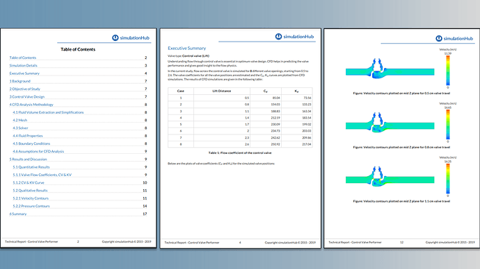

- Valve Performance Report
The Autonomous Valve CFD app comes with a unique report generation feature. We have extracted required and critical information about analysis to compile a ready-to-use PDF report.
The results generated using Autonomous Valve CFD app helps the manufacturers to directly share it with their customers. The valve manufacturers can also publish this report on their respective websites for more transparency between their end-users and for easy reachability. This helps valve authorities to get recognized by their valuable customers. As the app is cloud-based multiple users can access the application. The user need not have to download CFD simulation files to view the results as all the post process has been automated. The result so generated by the app can be accessed from any location using the devices like phones, tab, desktops.
