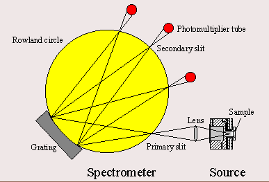

A Glow Discharge Optical Emission Spectrometer (GD-OES) is built of a glow discharge source and one or more optical spectrometers, including detectors, either Photomultiplier tubes or solid state detectors, usually CCD’s.
A schematic layout is given to the above. The spectrometer displayed here using a concave grating in the Rowland circle or Paschen-Runge configuration and photomultiplier tubes for the light detection.
