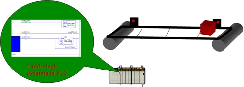

Ladder Logic Example :
• Here, we can see an example of ladder logic. Each line of code is known as a “rung”. In this example there are 4 rungs, numbered 0, 1 and 2, and the end rung marking the end of the program.
• The PLC executes the program 1 rung at a time, starting with the first rung and then working down.
• Ladder logic rungs are basically IF-THEN statements. Each individual rung is executed from the left to the right. The outputs at the right side of each rung is set to a condition that reflects the status of the permissive contacts in a particular rung.

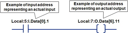

• If there are multiple OTE’s on the rung, then all would be turned on or off based on the rung condition (true or false).
• The text above the XIC and OTE is the address associated with the instruction. PLC addresses may appear in many different ways depending on the PLC being used :
-> Start_Button
-> Local:2:I.Data[0].1
-> I:020/2
• The address is used by the PLC to tell exactly which input to read or which output to command.

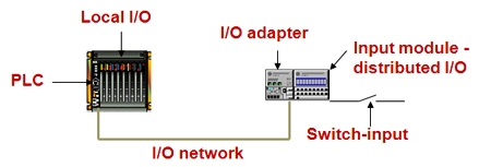

I/O Systems :
I/O systems are often referred to as local or distributed :
• Local refers to the I/O being attached directly to the controller or on the same backplane as the Controller.
• Distributed refers to I/O which is not on the same backplane as the Controller. Distributed I/O is connected using a network.
The distributed input module sends the inputs across the backplane to the adapter. The adapter sends them over the I/O network to the PLC (Controller).
I/O Architectures :
I/O architectures are made up of I/O systems. The architectures are referred to as Centralized and Distributed :
• Centralized refers to the I/O being located near or in the same cabinet as the processor. Wires from field devices are brought back to the I/O, and can be quite long.
• Distributed refers to I/O that is located near the field devices. The wires from the field devices are short. The network cable is run out to the Distributed I/O instead of running the field wires back to the I/O.
Systems Vs. Architectures :
• I/O systems are part of an I/O architecture :
-> If all the I/O is located near or in the same cabinet as the processor, it is a centralized architecture. Within the centralized architecture could be either local or distributed I/O, or both.
-> If some of the I/O is located remotely from the processor it is a distributed architecture. Within the distributed architecture is distributed I/O, or both local and distributed I/O.

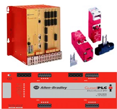

Safety System :
• The Function of a Safety System is to monitor and control conditions on a machine or process that are hazardous in themselves or, if no action were taken, may give rise to hazardous situations.
• The Safety System runs in parallel with the Control System. The Control System and Safety System may share components :
-> Focus of Control System is Throughput.
-> Focus of Safety System is Protection.
• A Safety system is designed to protect :
-> People.
-> Environment.
-> Machinery.
• The safety system is often referred to as ” safety control” while the PLC system controlling the devices that produce the end product is often referred to as the “ standard control”.
