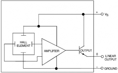

Circuitry
Hall sensors come in small IC packages and usually have three pins. The inside is simplified in the diagram below:
Hallsensorcircuit.jpg|400x246

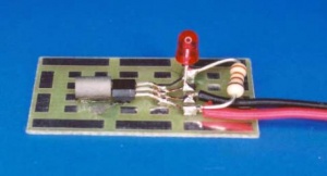

A Switch
The following circuit shows how a hall effect sensor can be used as a switch. The LED will light up when the sensor detects a change in the magnetic field.
Hall effect switch.jpg|300x294

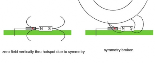

Detecting a Nearby Ferrous Object
You can use a hall-effect sensor to detect a nearby metal object. An example of how to assembly such a sensor is shown below:
Ferrous sensor.jpg|300x162
A small magnet is placed next to the hall effect sensor. Normally, the magnetic fields are uniform, but as a metal object approaches, they are changed. The hall sensor picks up on this change and outputs a voltage.
Ferrous sensor operation.jpg|500x206

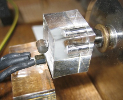

Angle Sensing
By mounting a bipolar magnet on a shaft and placing a hall sensor near it, you can use the hall sensor to measure the angle of rotation of the shaft.
The setup below was used in the “haptic paddle” project. The small magnet is attached to the shaft and the small hall sensor is just below it.
Hallsensorsetup.jpg|400x325
