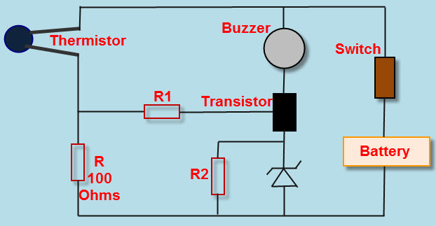

A simple heat detector circuit is shown in the figure that can be used as a heat sensor. In this heat detector circuit diagram, a potential divider circuit is formed with a series connection of thermistor and 100 Ohms resistance. If (Negative temperature Coefficient) N.T.C type thermistor is used, then the resistance of thermistor decreases after heating. Thus, more current flows through the potential divider circuit formed by thermistor and 100 Ohms resistance. Hence, more voltage appears at the junction of thermistor and resistor.
Heat Detector Circuit
Let us consider thermistor having 110 Ohms, and after heating its resistance value becomes 90 Ohms. Then, as per potential divider circuit which is pervasive concept namely voltage divider: the voltage across one resistor and the ratio of that resistor’s value and the sum of resistances times the voltage across the series combination are equal. The input-output relationship for this heat detector circuit system, takes the form of a ratio of the output voltage to the input voltage which is given by the voltage divider concept in this particular concept.
Finally, the output voltage is applied to NPN transistor shown in the circuit through a resistor. A zener diode is used to maintain emitter voltage at 4.7 volts, which can be used comparatively. If the base voltage is greater than the emitter voltage, then the transistor starts conduction. This is because as the transistor gets more than 4.7V base Voltage and a buzzer are connected to complete the heat detector circuit which is used for producing sound.

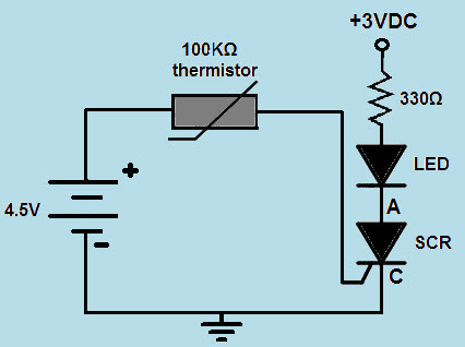

Heat Detector Circuit Using SCR and LED
The heat detector circuit is designed using thermistor, but instead of using transistor and buzzer, here SCR and LED are used. The SCR is connected in series with the LED. Here LED is used as an alerting element. The RED LED connected in the circuit is switched to indicating the significant change in heat sensed by the thermistor.
Heat Detector Circuit using SCR and LED
Generally, thermistor offers very high resistance (approximately equal to its rated value of 100KΩ) at room temperature. Due to this very high resistance, practically no current will flow. Hence, no triggering pulse is given to the SCR gate terminal. But, if a significant amount of heat is sensed by the thermistor, then the resistance of a thermistor significantly decreases. Thus, sufficient amount of current flows through the circuit and the gate terminal of SCR is triggered. Therefore, the LED connected in series with the SCR is turned ON as an alert indicating the change in heat.

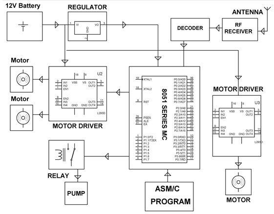

Firefighting robot controlled using RF transmitter and RF receiver is a simple example electronics project, which is a practical application of heat detector. The circuit consists of heat detector (thermistor) that is connected to the microcontroller of the receiver block which is interfaced with robotic vehicle. Under normal room temperature, the robot’s heat detector will not give any signal to the microcontroller and thus pump remains off.
If once heat detector detects any considerable change, then it sends signal to the microcontroller. Further, the microcontroller sends a signal to the pump through a relay to activate it and extinguish the fire (if any). Thus, heat detector can be used in real time embedded systems based project firefighting robotic vehicle and industrial temperature controller project.

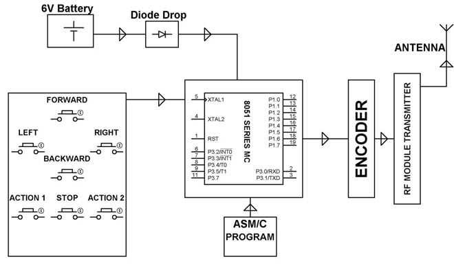

This robotic vehicle can be controlled using RF technology consisting of RF transmitter and RF receiver. RF transmitter can be used by the controller to send commands to robotic vehicle to move into the specific direction: left or right or forward or backward and also to start or stop the robotic vehicle. RF receiver connected to the robotic vehicle receives these commands. These commands are fed to the microcontroller and thus the microcontroller controls the motors direction accordingly through a motor driver IC.
