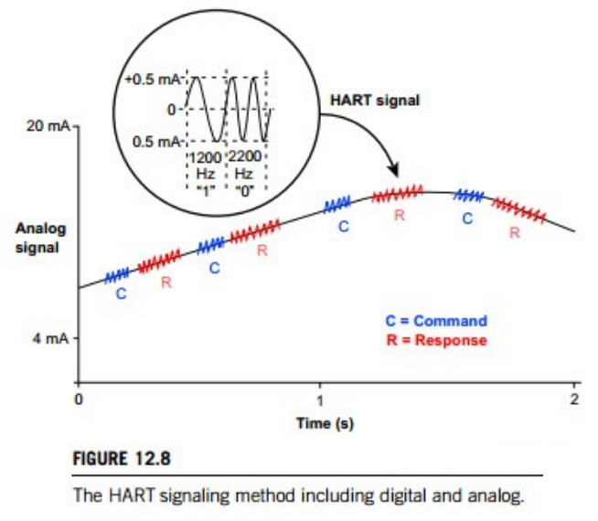

HART communication occurs between two HART-enabled devices, typically a field instrument or device and a control or monitoring system. An analog measurement signal is used to transmit digital information, and an additional signal is modulated to the measurement signal by using the frequency shift keying (FSK) technique.
With the FSK, the two frequencies of the additional signal; 1200 and 2200 Hz, to represent the bit values 1 and 0, respectively. This makes it possible to transfer additional information without affecting the analog measurement signal. As indicated by Figure 12.8, HART provides two simultaneous communication channels: the 4 20 mA analog signals and a digital signal. The 4 20 mA signal communicates the primary measured value (in the case of a field instrument or device) using the 4 20 mA current loop, the fastest and most reliable industry standard. Additional
device information is communicated using a digital signal that is superimposed on the analog signal containing information such as device status, diagnostics, additional measured or calculated values. Together, the two communication channels provide a complete field communication solution that is easy to use and configure, is low-cost and is very robust.

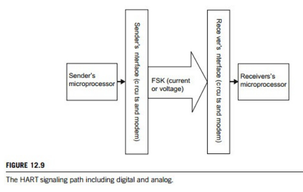

The HART signal path from the microprocessor in a sending device to the microprocessor in a receiving device is displayed in Figure 12.9. Amplifiers, filters, and the network between these two interfaces have been omitted for simplicity. At this level the diagram is the same, regardless of whether a master or slave is transmitting. Notice that, if the signal starts out as a current, the FSK is a voltage, but if it starts out a voltage it stays a voltage.
The transmitting device begins by turning on its carrier and loading the first byte to be transmitted into its interface circuits. It waits for the byte to be transmitted and then loads the next one. This is repeated until all the bytes of the message (these messages are always defined as commands that are of predefined format) are exhausted, then it waits for the last byte to be serialized and finally turns off its carrier. With minor exceptions, the transmitting device does not allow a gap to occur in the serial stream; the start and stop bits are used for synchronization and the parity bit is part of the HART error detection.
The serial character stream is applied to the modulator of the sending modem. The modulator operates such that a logic 1 applied to the input produces a 1200 Hz periodic signal at the modulator output. Logic 0 produces 2200 Hz. The type of modulation used is called continuous phase frequency shift keying (CPFSK). “Continuous phase” means that there is no discontinuity in the modulator output when the frequency changes. When the sender’s interface output (modulator input) switches from logic 1 to logic 0, the frequency changes from 1200 to 2200 Hz with just a change in slope of the transmitted waveform. A moment’s thought reveals that the phase does not change through this transition. Given the chosen shift frequencies and the bit rate, a transition can occur at any phase.
At the receiving end, the demodulator section of a modem in its interface converts FSK back into a serial bit stream at 1200 bps. Each character is converted back into an 8-bit byte and parity is checked. The receiving microprocessor reads the incoming bytes from its interface and checks parity for each one until there are no more, or until parsing of the data stream indicates that this is the last byte of the message.
The receiving microprocessor accepts the incoming message only if its amplitude is high enough to cause carrier detect to be asserted. In some cases, the receiving microprocessor will have to test an I/O line to make this determination. In others, the carrier detect signal gates the receive data so that nothing (no transitions) reaches the receiving interface unless carrier detect is asserted.

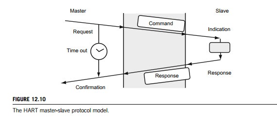

HART communication uses a master-slave protocol, which means that a field device as slave speaks only when it is spoken to by a master. In every communication, a master device sends a command message first; the slave device processes it and then sends back a response message (Figure 12.10). Both the command and response messages include the HART data and must be formatted in accordance with the relevant HCF (HART Communication Foundation) specifications.
The HART protocol can be used in various modes for communicating information between devices, including analog plus digital signals, or digital only signals. Digital master-slave communication together with the 4 20 mA analog signals is the most common. This mode, depicted in Figure 12.10, allows digital information from the slave device to be updated twice per second in the master. The 4 20 mA analog signals are continuous and can still carry the primary variable for control. Please note that when a communication between the master and the slave is engaging, interrupt is definitely not allowed.
A burst is an optional communication mode (Figure 12.10) which allows a single slave device to continuously broadcast a standard HART response message. This mode frees the master from having to send repeated command requests to get updated process variable information. The same HART response message is continuously broadcast by the slave until the master instructs the slave to do otherwise. Data update rates of 3 4 per second are typical in burst-mode communication, but will vary with the chosen command. Please note that the burst mode should be used only in single slave device networks.
Two masters (primary and secondary) can communicate with slave devices in a HART network. Secondary masters, such as hand-held communicators, can be connected almost anywhere on the network and communicate without disturbing the primary master, typically a PLC, or computer- based central control or monitoring system. A typical installation with two masters is shown in

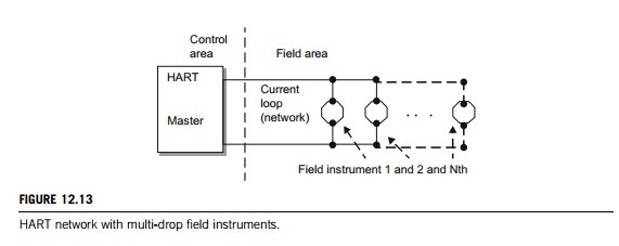

Figure 12.12 and Figure 12.13. From an installation perspective, the same wiring that is used for conventional 4 20 mA analog instruments carries HART communication signals. Allowable run lengths will vary with the type of cable and the devices connected, but can in general be up to 3000 m for a single twisted pair cable with shield, and 1500 m for multiple twisted pair cables with a common shield. Unshielded cables can be used for short distances. Intrinsic safety barriers and isolators which pass the HART signals are readily available for use in hazardous areas.
HART protocol also has the capability to connect multiple field devices on the same pair of wires in a multi-drop network configuration, as shown in Figure 12.12(b). In multi-drop networks, communication is limited to master-slave digital only. The current through each slave device is fixed at the minimum value needed to power the device (typically 4 mA) and no longer has any meaning for the process.

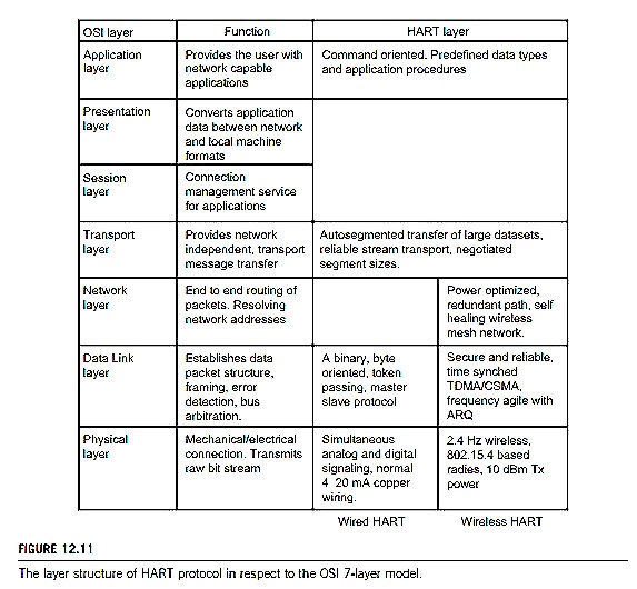

HART protocol utilizes the OSI 7-layer reference model. As is the case for most of the communication systems at field level, it implements only layers 1, 2, and 7 of the model. Layers 3 6 remain empty since their services are either not required or are provided by the application layer 7 (see Figure 12.11).
The application layer defines the commands, responses, data types, and status reporting sup- ported by the protocol. In addition, there are certain conventions in HART (e.g., how to trim the
network current) that are also considered part of the application layer. While the Command Summary, Common Tables, and Command Response Code Specifications all establish mandatory application layer practices (including data types, common definitions of data items, and procedures), the Universal Commands specify the minimum application layer content of all HART-compatible devices.

A HART field instrument is sometimes configured so that it has no analog signal, only a HART function. Several such devices can be connected together (electrically in parallel) on the same network, as shown in Figure 12.13, in which case they are said to be multi-drop, and the master is able to talk to and configure each one in turn. When field instruments or devices are multi-drop there cannot be any analog signaling, and the term current loop ceases to have any meaning.
Multi-drop field instruments powered from the network draw a small, fixed current (usually 4 mA) to maximize the possible number of devices. A field instrument or device that has been configured to draw a fixed analog current is said to be parked; accomplished by setting the short-form address of the field instrument or device to some number other than 0. A hand-held communicator might also be connected to the network, as displayed in Figure 12.13.
There are few restrictions on building wired HART networks. The topology may be loosely described as a bus, with drop attachments forming secondary buses as desired, as illustrated in Figure 12.14. The whole collection is considered a single network. Except for the intervening lengths of cable, all of the devices are electrically in parallel.

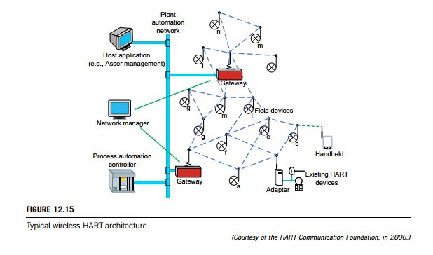

(2) Wireless HART networks
Wireless HART is the first open and interoperable wireless communication standard that has been designed to address the critical needs of the process industry for reliable, robust, and secure wireless communication.
A wireless HART network consists of field devices, at least one gateway, and a network manager, all wireless. These components are connected into a wireless mesh network supporting bidirectional communication. Figure 12.15 shows a typical wireless HART network architecture with only the principal devices plotted, which are as follows:
(1) Network manager
The network manager is the application software that manages the mesh network and network devices. It: (a) forms the mesh network; (b) allows new devices to connect to the network; (c) sets the communication schedule of the devices; (d) establishes the redundant data paths for all communications; and (e) monitors the network.
(2) Gateway devices
The gateway device connects the mesh network with a plant automation network, allowing data to flow between the two network devices. It provides access to the wireless HART devices for a system or other host application.
(3) Network devices
A network device is a node in the wireless mesh network. It can transmit and receive wireless HART data and perform the basic functions necessary to support network formation and maintenance. Network devices include field devices, router devices, gateway devices, and mesh hand-held devices.
(a) Field devices. The field device may be a process-connected instrument, a router, or hand-held device. The wireless HART network connects these devices together.
(b) Router device. A router device is used to improve network coverage (to extend a network), so it is capable of forwarding messages from other network devices.
(c) Process-connected instrument. It is typically a measuring or positioning device used for process monitoring and control; it is also capable of forwarding messages from other network devices.
(d) Adapter. An adapter is a device that allows a HART instrument without wireless capability to be connected to a wireless HART network.
(e) Hand-held support device. Hand-held devices are used in the commissioning, monitoring, and maintenance of network devices; they are portable and operated by plant personnel.
Wireless HART networks can be configured into a number of different topologies including the following:
  1. Star network. Star networks have just one router that communicates with several end devices. This is one of the simplest network topologies, appropriate for small applications.
  2. Mesh network. Mesh networks are formed by network devices that are all routers. They provide a robust network with redundant data paths, able to adapt to changing radio frequency environments.
  3. Star mesh network. These are a combination of the above two.
