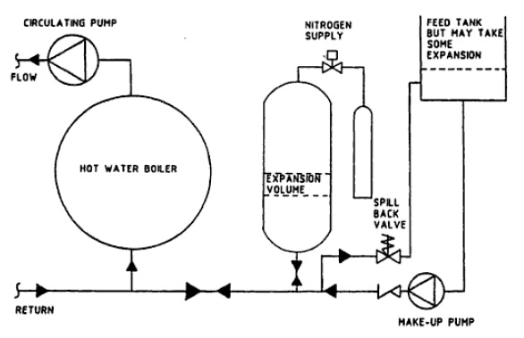

Nitrogen pressurization method – this method uses nitrogen that is compressed in a vessel tank and distributed together with water as shown in Figure 1 below.
Figure 1: Nitrogen Pressurization Method

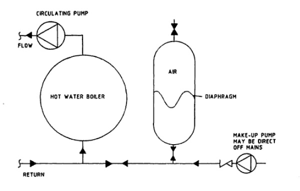

Diaphragm air pressurization method – this method uses compressed air as above method but it uses diaphragm of neoprene as shown in Figure 2 below among water and air.
Figure 2: Diaphragm Air Pressurization Method

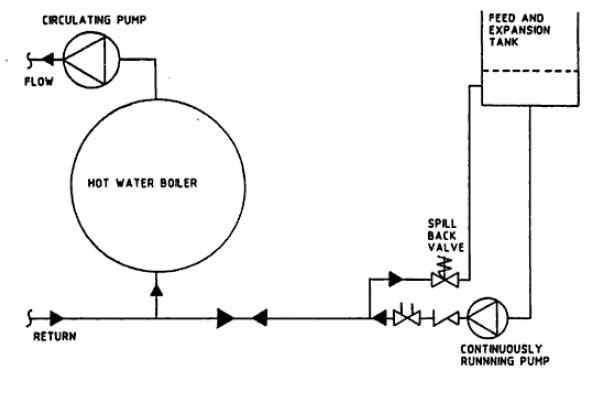

Pressure pump method – this method uses pump to produce pressure in the hot water heating boiler system as shown in Figure 3 below.
Figure 3: Pressure Pump Method of Hot Water Heating Boiler
