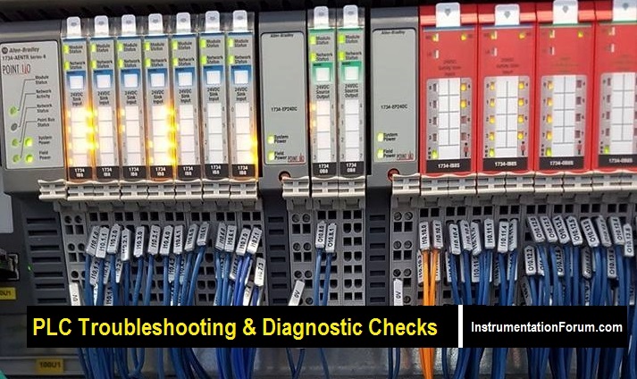

Study How-to do PLC (programmable logic controller) Troubleshooting and Diagnostic Checks with this procedure and how to identify the PLC problems.
PLC Troubleshooting and Diagnostic Checks
