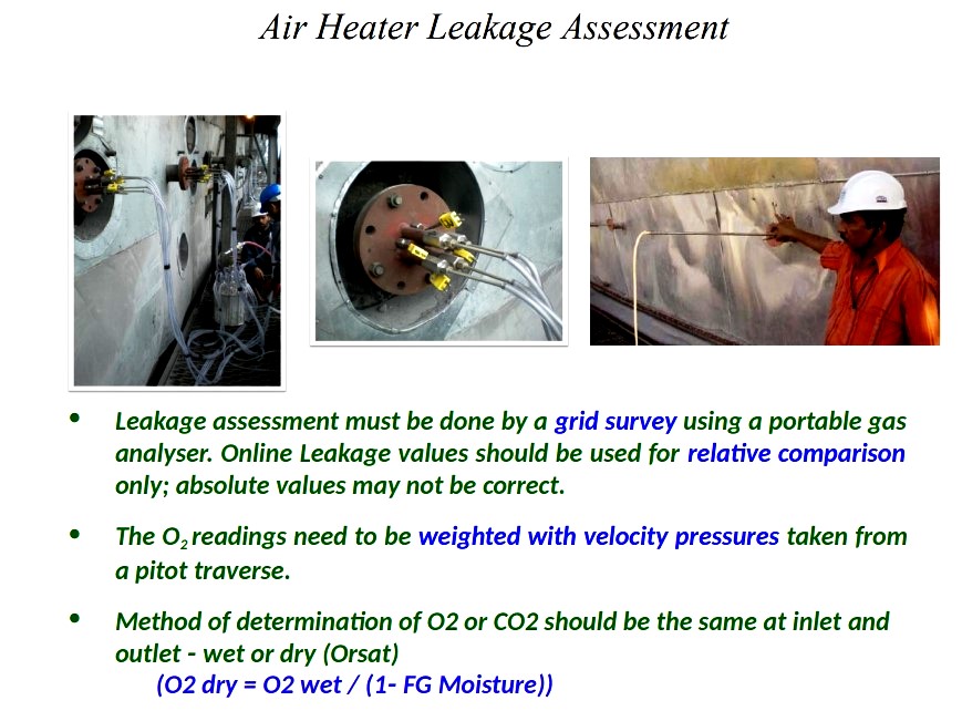

AH Tests –Measurements
• Gas analysis & Temp at APH inlet, outlet & at ID Fan Outlet
• Temperature of Primary & Secondary Air at AH in/outlet
• Power Measurement – Mills & Fans
• Control Room Data
Measurement Locations
The number and type of instruments required for conducting this test depend on the unit being tested. The following table lists the measurement locations.
Measurement Temperature Gas Analysers Pressure
AH Gas Inlet Yes Yes Yes
AH Gas Outlet Yes Yes Yes
AH Air Inlet Yes Yes
AH Air Outlet Yes Yes
