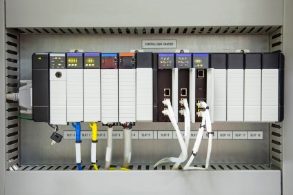

Allen Bradley
Allen Bradley offers a variety of PLC systems including its main flagship platform ControlLogix, along with the smaller sized CompactLogix and MicroLogix.
The ControlLogix and CompactLogix are modular systems that offer a wide choice of processors with different options based on memory sizes, on-board communication requirements, redundancy, safety integration and environmental considerations (extended temperature, conformal coating, etc.).
The ControlLogix platform consists of a separate base chassis, or rack, power supply, processor, I/O and communications modules. There are multiple configuration options available, from small single processor systems with a minimal I/O, to large redundant systems with an extensive I/O count and multiple remote I/O drops, all of which are scalable.
The cost for a ControlLogix system is the highest of the Allen Bradley PLC range, however this is reflected in its proven long life and reliability along with its large-scale control system capabilities. Where criticality or reliability is paramount, ControlLogix is the preferred platform.
CompactLogix consists of a separate power supply, processor and I/O modules, with or without on-board communications, all of which is DIN rail mounted. CompactLogix is typically used where a smaller system or cost is a consideration, although still designed with long life and expandability options.
The MicroLogix is a small ‘brick’ style PLC with a built-in power supply, processor and I/O with expansion modules available. The MicroLogix system is designed for smaller process and automation control tasks or can be integrated into a larger CompactLogix or ControlLogix system.
For those looking to upgrade an existing Allen Bradley system, all new products have good backward compatibility and legacy support, ensuring there is a migration path from previous models. Product software is also upgraded when a new product comes out to ensure any new hardware features are supported.
Allen Bradley’s support service is among the best of the PLC vendors, however there is a charge for programming software, and customers are required to pay an additional annual support fee in order to upgrade and receive the support.

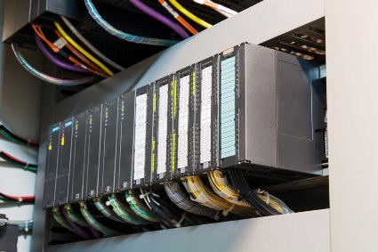

Siemens
Siemens has a wide range of PLC options available, from basic controllers through to large-scale redundant platforms utilised on some of the world’s largest and most complex engineering projects.
The current flagship of Siemens PLC range is the S7-1500 advanced controller, with a 1ns ‘bit processing time’ in the CPU and features such as built-in Profinet, 4-Level security, integrated display and native OPC UA accessibility. The S7-1500 is one of the most feature rich PLC platforms on the market today.
In addition to the advanced S7-1500, Siemens has the range of industry proven S7-300 and S7-400 controllers, the latter of which provides a full redundancy option. One of the features of its S7 PLC range is that it can offer two safety runtime groups, which means the infrastructure can be divided into two groups with each section having different control parameters, including priorities and time cycles. The benefit of this is that operators don’t need to stop any processes when modifying the programing blocks and downloading them to the PLC.
Historically, the Siemens S7 PLC programming environment could be challenging for the uninitiated, however the latest Total Integrated Architecture (TIA) software suite provides a wide range of programming options that makes it easier than ever to configure and set up not only PLCs, but HMIs, drives and other associated Siemens equipment. Siemens also offers standard technical support for free.

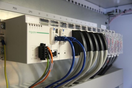

Schneider Electric
Schneider Electric’s main PLC range, Modicon, provides various platforms of all sizes from small brick style controllers through to the M340 and M580 redundant system and numerous legacy systems like Quantum, Premium and Momentum. Schneider Electric PLCs, PACs and dedicated controllers are easy to program, commission, maintain and are IIOT ready.
This range is particularly good in applications where hot redundancy is required as the Ethernet/IP standards have been incorporated, allowing for deterministic distributed I/O.
PLC to PLC communications is very easy with Schneider Electric’s Unity software and it is favoured by many engineers for this reason. The local support within Australia is quite extensive with large offices in most major cities.
