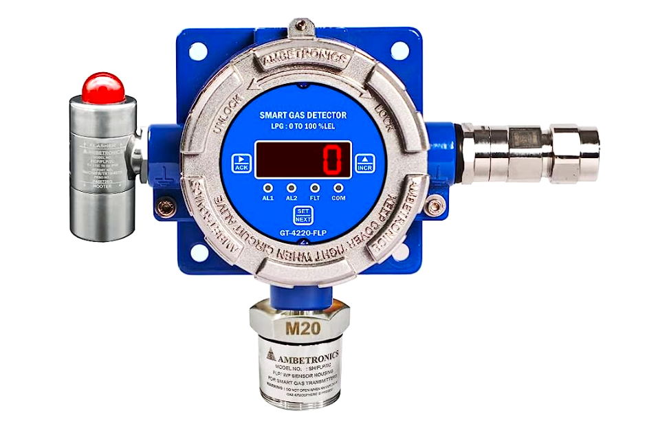

Does anyone know how to verify or calibrate the LPG gas detector?
Calibrating an LPG (Liquefied Petroleum Gas) detector is important to ensure its accuracy and proper functioning.
Calibrate the LPG Gas Detector
Here’s a general guideline on how you might do it, but remember, the specifics may vary depending on the manufacturer and model of your gas detector:
  1. Refer to the Manufacturer’s Instructions: Always check the manual or instructions that came with your specific LPG detector. Different models can have different calibration processes, and it’s important to follow the manufacturer’s guidance.
  2. Obtain Calibration Gas: You’ll need a cylinder of calibration gas that is a known concentration of LPG, typically in air. The concentration used should be within the detection range of your instrument. This calibration gas can often be purchased from the same company that made the detector.
  3. Use a Regulator and Tubing: Attach a regulator to the cylinder of calibration gas. The regulator controls the flow of gas from the cylinder. Connect tubing from the regulator to the gas detector’s calibration port.
  4. Turn on the Detector and Calibration Gas: Follow the manufacturer’s instructions to start the calibration process. Typically, you will need to navigate to a calibration setting or mode on the detector. Once in this mode, turn on the calibration gas so that it flows into the detector.
  5. Allow the Detector to Calibrate: The detector should now start to read the concentration of the calibration gas. It might take a few minutes for the reading to stabilize.
  6. Adjust the Detector’s Reading: Once the reading is stable, compare it to the known concentration of the calibration gas. If there is a discrepancy, adjust the detector’s reading (again, following manufacturer’s instructions) until it matches the known concentration.
  7. Turn Off the Calibration Gas and Remove the Tubing: Once the detector is correctly calibrated, turn off the flow of calibration gas and disconnect the tubing. The detector should now be calibrated and ready to use.
  8. Document the Calibration: Always document the calibration process, including the date, the known concentration of the calibration gas, and any adjustments made to the detector. This can be important for maintaining compliance with safety regulations.
