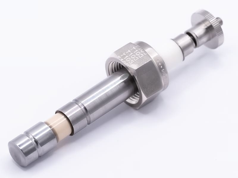

Hydrastep use conductivity level probes as the sensing element of the system. They are often made from stainless steel and zirconia brazed together.
They work on the principle of resistance, specifically the difference in resistance between steam and water. Because steam has a very big resistance and water has a very small resistance, it is possible to use electronics to turn that resistance into a level indicator.
Conductivity probes have a metal stud and tip that are completely isolated from the metal body but a brazed insulator. The probe is inserted into the water column and its body forms part of the earthing (grounding) system of the electronic unit.
An alternating electrical current is applied to the probe stud and tip from the electronic unit. When water bridges the gap between the tip and the body, the electrical circuit is complete and the electronic indicates this as a water state. If the water does not bridge the gap, it is indicated as a steam state. Each probe in the system has its own circuit and LED indicator channel.
