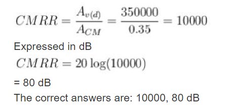

If Av(d) = 3500 and Acm = 0.35, the CMRR is
A. 1225
B. 10,000
C. 80 dB
D. Both B and C
Answer: D
A. 1225
B. 10,000
C. 80 dB
D. Both B and C
Answer: D
Please give me resion
