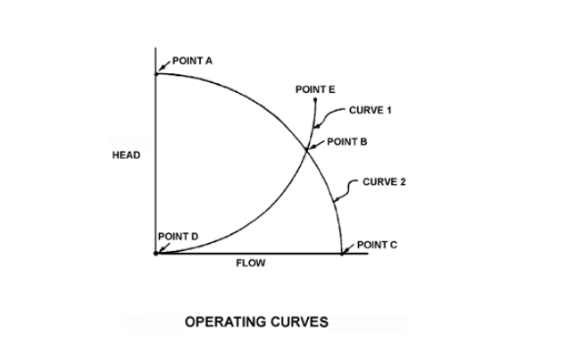

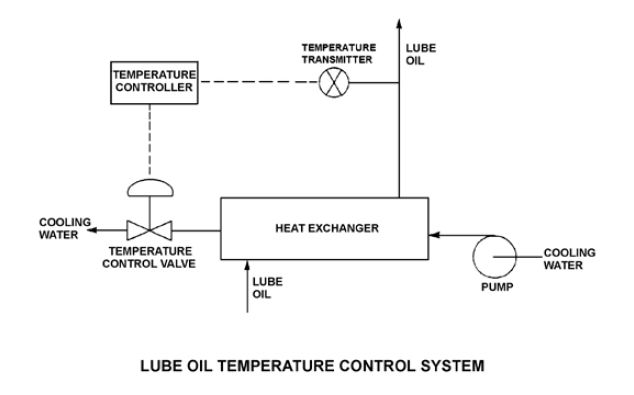

If the pump is initially operating at point B, how will the operating point change if the temperature controller setpoint is decreased by 10°F ___
Refer to the drawing of a lube oil temperature control system and the associated pump/system operating curves (see figure below).
lube oil temperature control system and the associated pump system operating curves -PG-92
lube oil temperature control system and the associated pump system operating curves -PG-92-2
If the pump is initially operating at point B, how will the operating point change if the temperature controller setpoint is decreased by 10°F?
A. Operating point B will be located on curve 1 closer to point E.
B. Operating point B will be located on curve 1 closer to point D.
C. Operating point B will be located on curve 2 closer to point A.
D. Operating point B will be located on curve 2 closer to point C.
Answer: D
