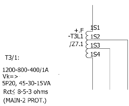

If we want to use 1200:1 from this multi-ratio CT, the secondary contacts will be
A. 1S1-1S3
B. 1S2-1S4
C. 1S1-1S4
D. 1S1-1S2
Answer: C
A. 1S1-1S3
B. 1S2-1S4
C. 1S1-1S4
D. 1S1-1S2
Answer: C
