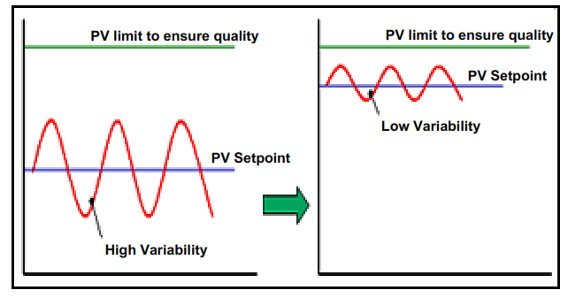

Reduce Variability
Process control can reduce variability in the end product, which ensures a consistently high-quality product. Manufacturers can also save money by reducing variability.
For example, in a gasoline blending process, as many as 12 or more different components may be blended to make a specific grade of gasoline. If the refinery does not have precise control over the flow of the separate components, the gasoline may get too much of the high-octane components.
As a result, customers would receive a higher grade and more expensive gasoline than they paid for, and the refinery would lose money. The opposite situation would be customers receiving a lower grade at a higher price.
Reducing variability can also save money by reducing the need for product padding to meet required product specifications. Padding refers to the process of making a product of higher-quality than it needs to be to meet specifications.
When there is variability in the end product (i.e., when process control is poor), manufacturers are forced to pad the product to ensure that specifications are met, which adds to the cost. With accurate, dependable process control, the setpoint (desired or optimal point) can be moved closer to the actual product specification and thus save the manufacturer money.
