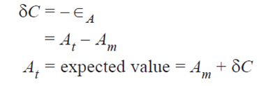

Correction:
The difference between the true value and the measured value of the sought quantity is defined as the reading correction or simply correction. That is, correction is negative or error. Thus,
Therefore addition of correction in measured value gives the true (or accurate or expected) value.
