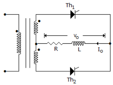

In the below figure the average load current is 15 A.
The rms value of transformer secondary current is
A. 15 A
B. 10.61 A
C. 7.5 A
D. 14.14 A
Answer: B
A. 15 A
B. 10.61 A
C. 7.5 A
D. 14.14 A
Answer: B
