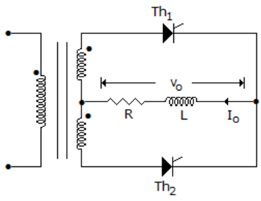

In the below figure, the average value of load current is 15 A.
The load is highly inductive.
The peak value of thyristor current is
A. 15 A
B. 15 √2A
C. 15 /√2) A
D. 30 A
Answer: A
