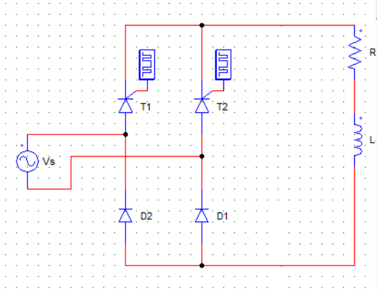

In the below given circuit, from ωt = π to α+π and continuous load current configuration
A. T1 and T2 conduct
B. T2 and D1 conduct
C. T1 and D2 conduct
D. T1 and D1 conduct
Answer: C
