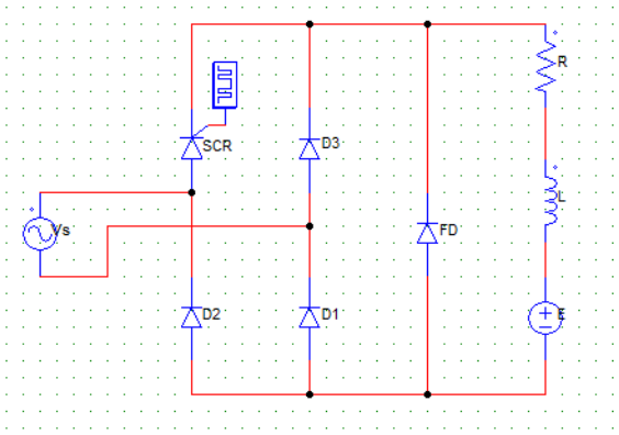

In the below given circuit, the average value of output voltage is 191 V.
Find the value of the average current through the given load if E = 100 V and R = 5 Ω.
Assume that the load current is continuous.
A. 0 A
B. 10.2 A
C. 18.2 A
D. 29.2 A
Answer: C
