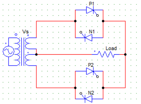

In the below given cycloconverter circuit, _________ and _________ conduct in one cycle together.
A. P1, P2 and N1, N2
B. P1, N2 and N1, P2
C. N1, P1 and N1, P2
D. None of the mentioned
Answer: B
