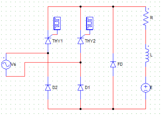

In the below shown semi-converter circuit T1 & T2 are fired at an angle α, the output voltage is zero when
A. π<ωt<α
B. 0<ωt<α+π
C. π<ωt<π+α
D. π<ωt<2π
Answer: C
