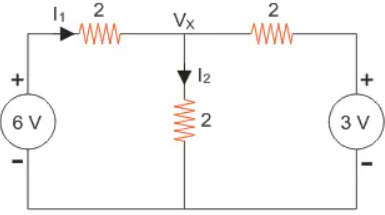

In the circuit shown in figure if I1 = 1.5 A, then I2 will be
A. 2 A.
B. 1.5 A.
C. 1 A.
D. 0.5 A.
Answer: B
A. 2 A.
B. 1.5 A.
C. 1 A.
D. 0.5 A.
Answer: B
