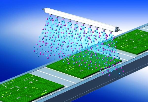

A range of static neutralizing products called ionizers are available, including from SMC. Ionizers create positively and/or negatively charged particles called ions by subjecting ambient air molecules to very high voltages, concentrated at the sharp points of needle-like emitters.
Some product forms include bars, fans, and nozzles. Each ionizer creates the ions and then propels them toward the target imbalanced material, using either compressed air or forced air from a fan. Once the ions come in contact with the undesirably charged material, electrons are traded, neutralizing the imbalance. The result of neutralized static is a more successful production operation and operator comfort.
Bar ionizers, such as SMC’s IZS41, come complete with built in high voltage power supply and ion emitters, as well as user settings and feedback controls.
